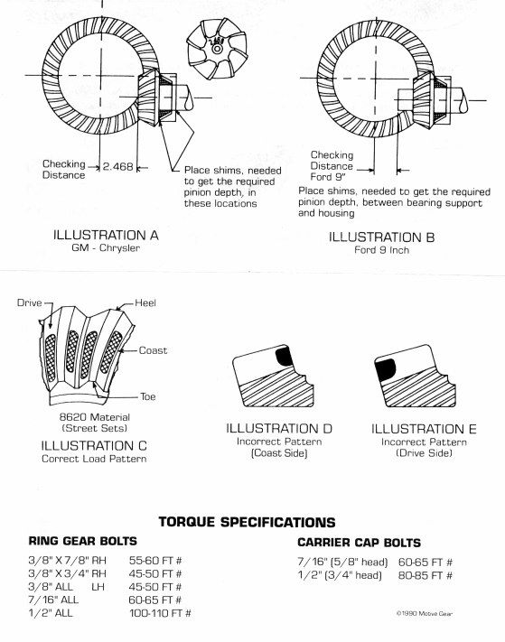

Each Motive Gear and Motive Gear Performance ring gear and pinion is pre-run and marked on the pinion face with its proper depth setting called the "Checking Distance." This dimension is from the face of the pinion to the axle centerline. A setting tool must be used to measure the checking distance. Pinion depth is adjusted by adding or subtracting shim thickness. Stay +/-.002 of the pinion dimension. (See illustrations ‘A’ and ‘B’).

You are now ready to verify the tooth contact pattern. A gear marking compound should be used. Paint gear teeth with compound in several spots and rotate ring gear several rotations. A tooth contact pattern will appear and should be similar to the pattern shown in illustration ‘C’. If the pattern is not in the approximate position shown, reset pinion depth and backlash to correct pattern. Pinion shims usually must be moved in .003 of an inch increments to notice a pattern change. If a pattern is heavy toe, subtract shims; (See Illustration ‘D’). If a pattern is heavy heel, add shims; (See Illustration ‘E’).
NOTE: reverse this procedure for 8" and 9" Ford.

I tried to attach the diagram of the illustrations listed but it would not work so e-mail me and I'll send it to you.
