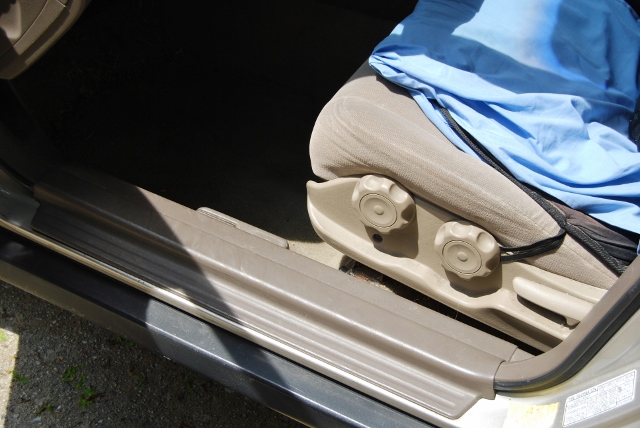

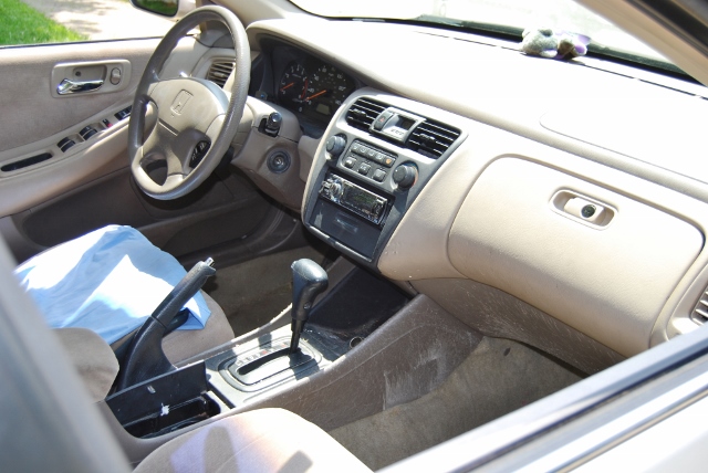

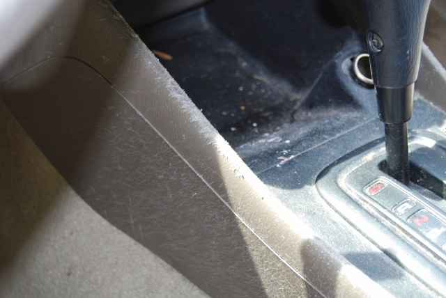

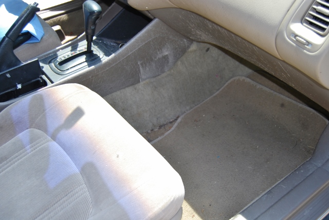

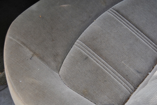

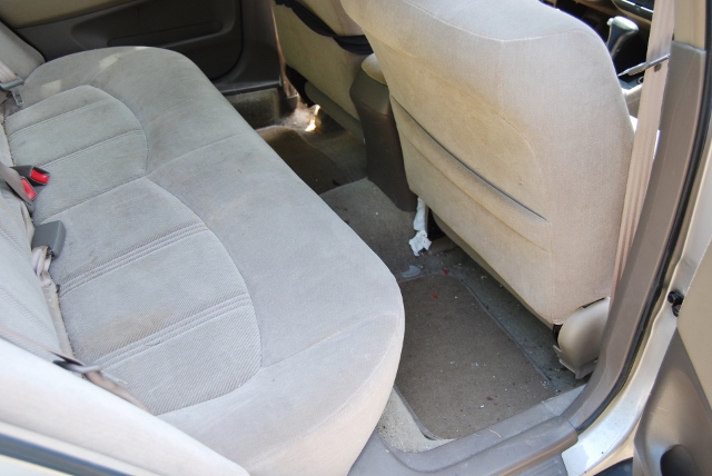

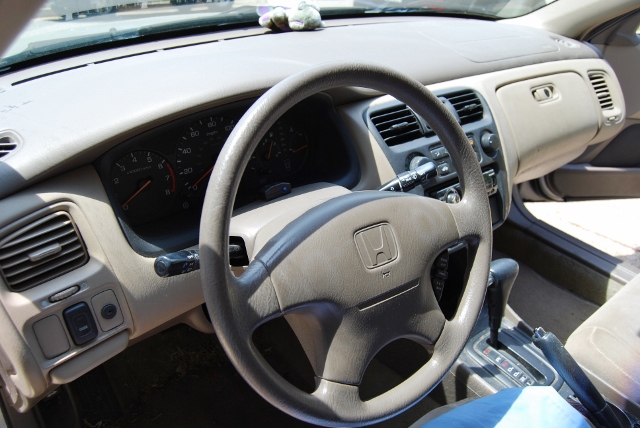

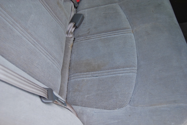

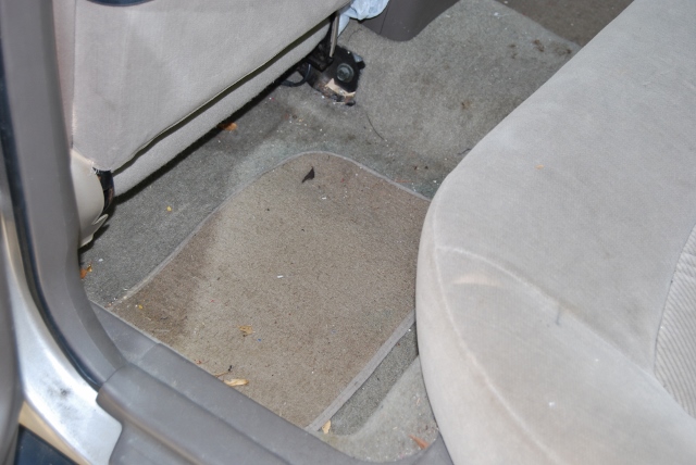

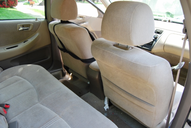

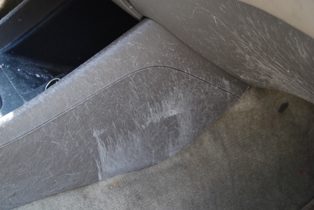

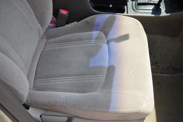

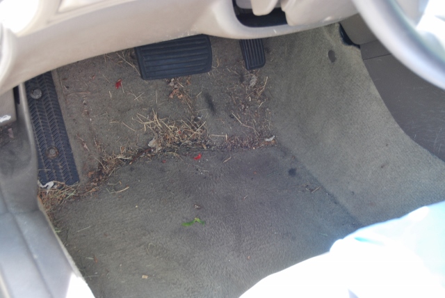

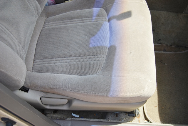

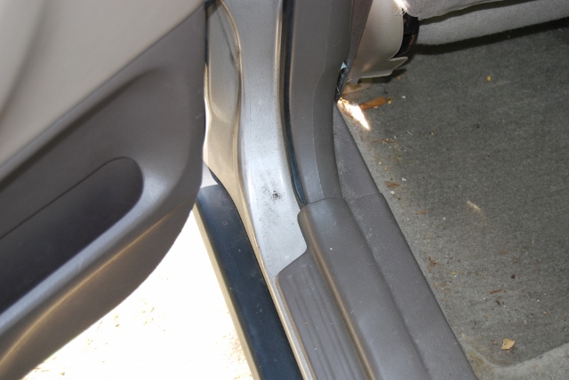

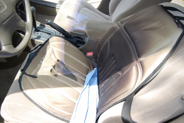

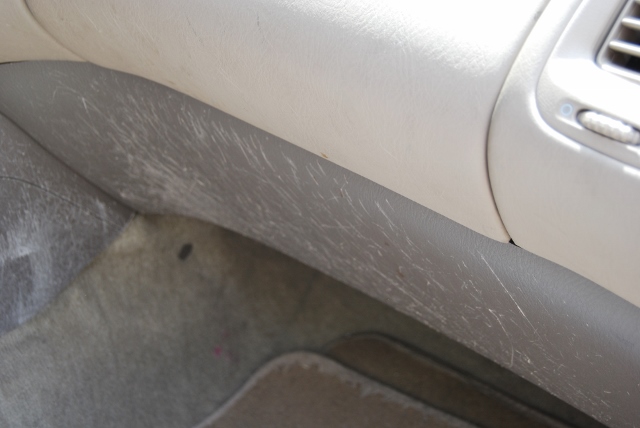

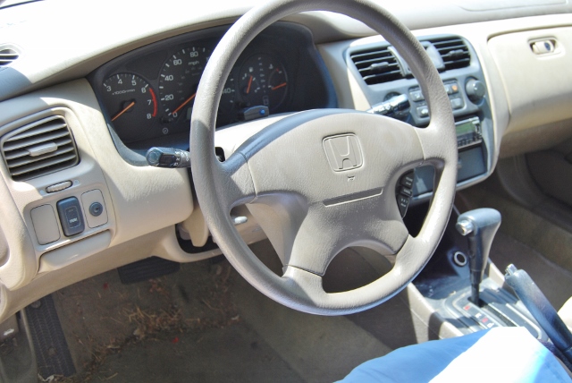

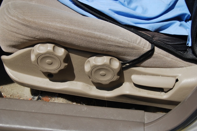

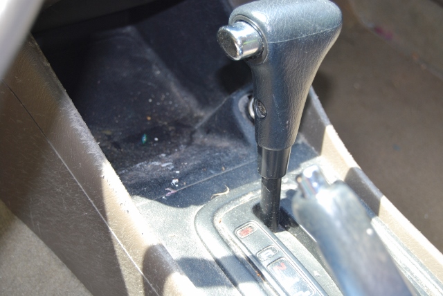

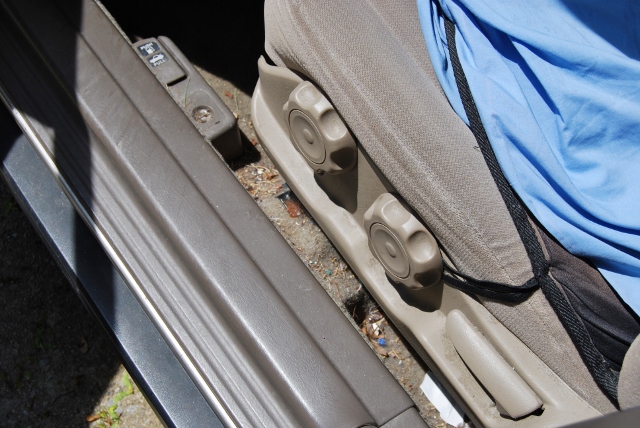

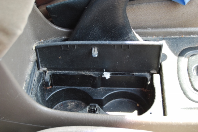

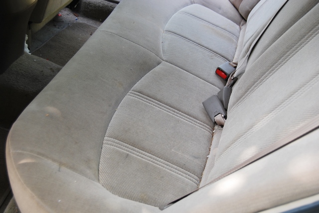

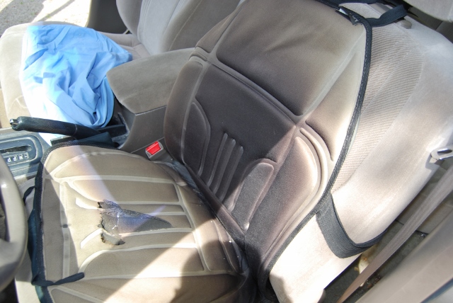

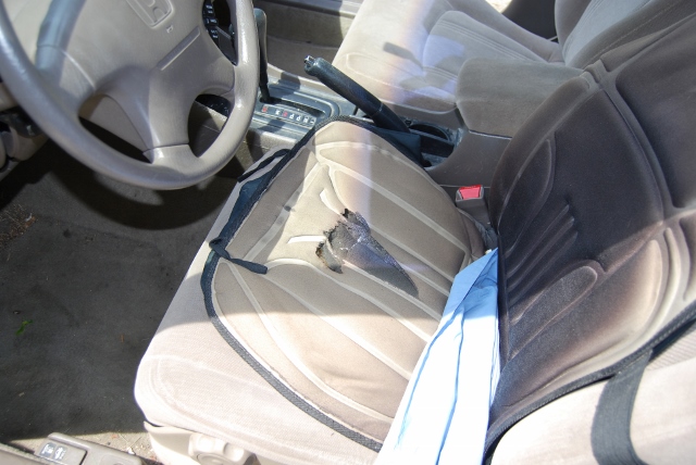

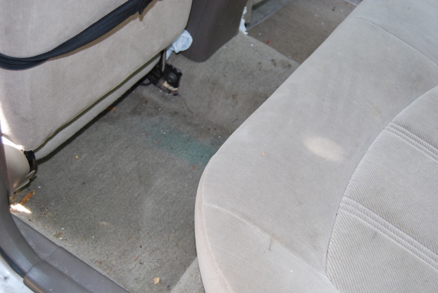

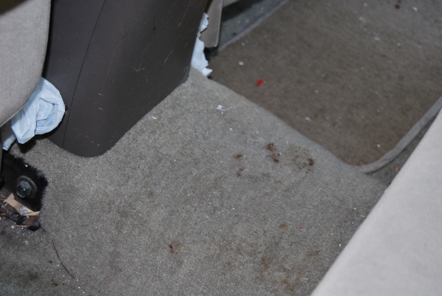

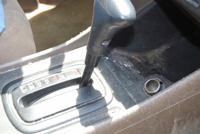

Okay boys and girls I'm finally getting to work on my friend Linda's 1999 Honda Accord. I had seen the car on several occasions but never had an opportunity to really look it over, inside and out before. It was in much worse condition that I imagined! :yikes: I'm jokingly calling this the "Lazarus" Project because I'm attempting to bring this car back from the dead.
Before leaving the car with me Linda filled two plastic grocery bags with the trash filling the seats and floor of the car. Since it was already evening and dark outside I guess I can forgive her for missing a few things, like the additional two grocery bags of trash that I filled on Friday when it was light outside.
The first thing I did was take my camera and go all around the car to note the "problem areas" I need to address. Then I did the same thing inside the car noting the heavily soiled carpets, carpeted floor mats, cloth upholstery, and the dirty plastic and vinyl interior. Since this was purchased as a used car I don't know if the heavily scratched and scuffed floor console and under dash areas were this way when she bought the car or if it happened during the time she has owned the car.
With the weather being uncooperative I decided to work on the interior of the car first. You will see before photos of the interior and then the progress photos of the vacuuming, carpet extractor and cleaning and dressing of the plastic and vinyl interior. When I begin to work on the exterior of the car I will follow the same pattern so as to show you the before and after results of the detailing. I will also name and show some of the products I am using along the way.
So here is where we begin with the way the car looked before I vacuumed or cleaned the interior.

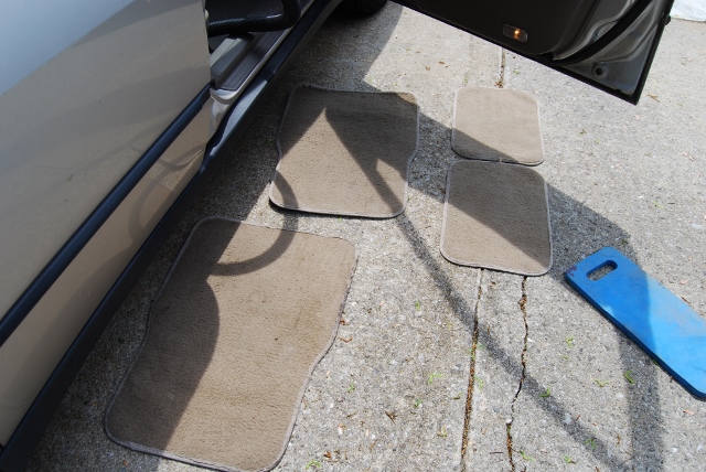

So far the interior cleaning only required basic cleaners and dressing products. I used Armor All Interior Cleaner and Greased Lightning Degreaser to clean the vinyl and plastic of the interior. I used a Craftsman 2 gallon wet/dry vac to vacuum the interior and a Bissell Spot Bot Portable Carpet Extractor and Bissell Concentrated Oxygenated carpet shampoo to clean the carpets and the fabric upholstery.
A trick that I learned as a sales rep for Odorite Janitorial Products is to use the degreaser to pretreat heavily soiled spots on the carpeting and upholstery. The degreaser breaks down the stain so that it is easily lifted with the carpet extractor.
To add protection to the newly cleaned vinyl and plastic I used Meguiars Supreme Vinyl Dressing. This product not only protects but also has cleaning properties. The vinyl and plastic on this car was extremely dry so I will add a second treatment as an extra preventative.
I was fortunate to take out nearly all of the stains in the carpeting. There was one small stain that has permanently been dyed into the carpet where I was able to lighten it a bit. The console was covered in dried up spilled coffee, hot chocolate and sticky soda residue and the long screwdriver was needed to clean out the crevices along the console.
Surprisingly I was able to thoroughly clean and brighten the carpet mats that were heavily soiled, dark and dingy looking. Once they dried they became much lighter in color and are now usable again.
I will be limited to what I can do to the exterior of the car although I'm confident that I will make it look much better that it is now. There are serious scratches that were "touched up" with paint that didn't match making the scratches even more noticeable. Once the car is washed, clay barred, polished and sealed it will take on a new life. There are several areas where the paint has faded so bad that there is nothing to work with. Eventually this car would require professional body work and a repainting, none of which is going to happen as long as Linda owns this car. But I can make this car look a heck of a lot better and that is our goal.
More to come as I begin working on the exterior starting on Monday.

PostPosted: Mon May 13, 2013 1:10 pm
MOTHER OF GOD!!!! :yikes:
what caused all of those scratches on the interior? a porcupine?

I have no clue as to what caused the deep scratches on the console and under the glove box James. I'll have to ask Linda when I get back from Ocean City.

PostPosted: Tue May 14, 2013 7:54 am
Thanks Dave! It has been a lot of hard work but at least I have achieved my goal of cleaning and restoring this car to a much better condition than when I received it from my friend.
As for the damage to the interior of this car I honestly don't know what caused that. I'll have to ask Linda when I get back from Ocean City as to how the car got so scratched and scuffed up.

My friend Linda picked up her car on Saturday afternoon when she returned from her cruise. Since I was still in Ocean City until Monday afternoon I didn't get to talk to her until today when she came by to pay me for detailing her car and to pick up her keys that I had during the time I was working on the car.
I had a chance to ask her how the passenger side interior became so scratched up. She uses a "club" devise that attached to the brake pedal which is awkward and heavy to lock up her car and deter someone from stealing the car. She said that the scratches came from her unlocking the club and placing it on the drivers side of the car. Because it is heavy and awkward the club sometimes comes in contact with the interior of the car and over the years these scratched occurred.

I'm glad in the end your hard work was greatly appreciated, you did an amazing job on that car!
I still think a porcupine broke into her car and did all that damage. :smile:
