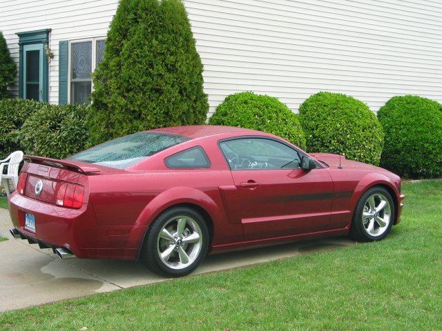

PostPosted: Sun May 20, 2007 11:48 pm
Posts: 46
Wayne
PostPosted: Mon May 21, 2007 8:37 pm
thanks hare, nice cali special! i really like the front and rear fascias much more than the stock ones.

are those the MAC mufflers on your car? and when you said three settings, do you mean the sway bar?

Posts: 46
HI, the exhaust is Borla exhaust from the Ford Racing catalog that the dealer installed and it is the front sway bar that is adjustable. How you like your suspension now?..is it stiffer than the stock? Adjustable? I am not finished with mine either, but pretty broke now after all the FR parts I just had installed. Later, I plan on upgrading the motor with at least a more radical cam and tune...not sure about turbo or supercharging but as I visit more car club site, like the one in OC(Ocean City Cruise) over the weekend, which was awesome by the way, I like seeing what others have had success with. I found "Boss281" there, and his stage 3 cams sounded really nice, but he said he was still working the bugs out of the tune that the shop did. Where do you run the autocross? I would like to try that.
