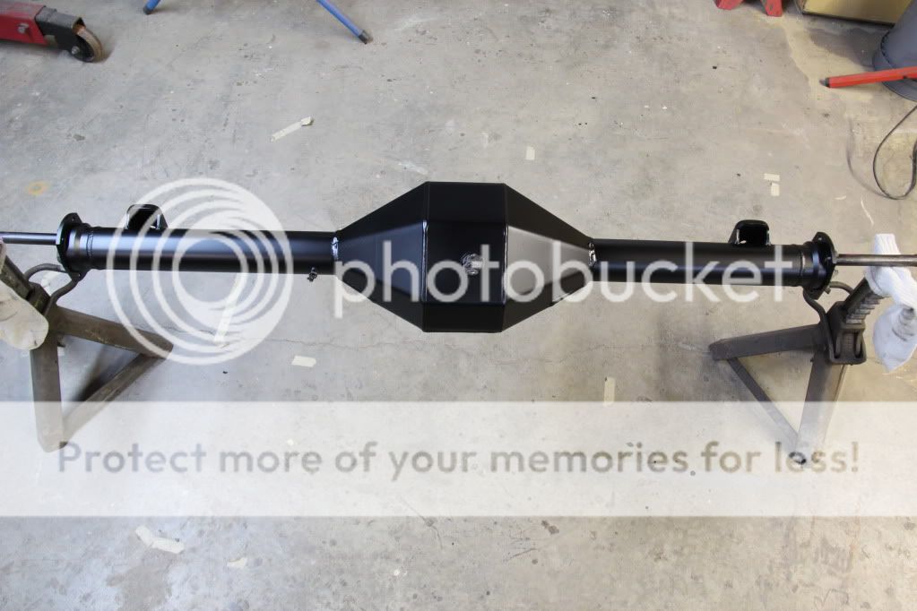

We received the new 9” rear, axles, and center section last week. Today we prepped it for paint.
All the parts were well packed; this is how sheet metal should be shipped!
Primed and painted, we will press on the axles bearing tomorrow and assemble the rear this weekend.
Thanks!
Pat

LOL, the first pic... I was like WOW a huge block of cheese!

We assembled the new 9” rear and looking forward to installing it in the car when we finish the body work and paint.
With the bolts loctited on for 24 hr we installed the 3rd member
I used a friends press to install the axel bearings and we cut the studs and loctited them on at 60 ft lb.
Funny how much longer one is from the other.
Axel and brakes installed and will make custom S/S brake lines next week.
Thanks! Pat
