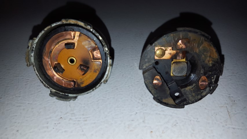

And the electrical gremlins have raised their ugly heads again. Back to a starting issue, but this time I think it might have something to do with the ignition switch. When I try to start the car, the engine turns over but doesn't catch, like it's not getting spark. However, it will start when I connect a remote start switch to the solenoid. The difference from stock is that I ran a separate wire from the ignition to the coil to bypass the balast wire. I definitely am not an electrical expert. Any thoughts, advice, suggestions, etc would be appreciated.

Follow up to the ignition switch: it was indeed bad. I replaced it with a new Scott Drake switch. Fitment was fine. She fires right up again!!!
