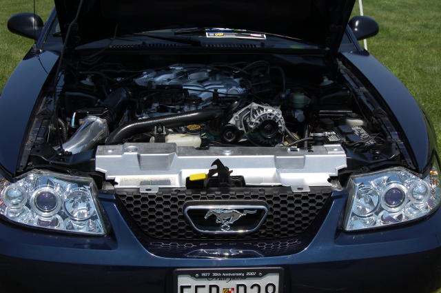

A clean engine really attracts people to your car and reinforces their opinions that your car is extra special since most people do not care what their car engines look like.
At the Reisterstown Festival Car Show a few weeks ago there was a 20 point penalty for not showing your engine! Even so a number of cars still had their hoods down, no doubt because they were embarrassed to show their dirty engines.
I actually take a lot of pride in cleaning and detailing my engine. It may not be a sexy V8 but it certainly looks better than the stock V6 and always gets a positive reaction from the spectators who attend the car shows.
Here are some photos of my engine.
