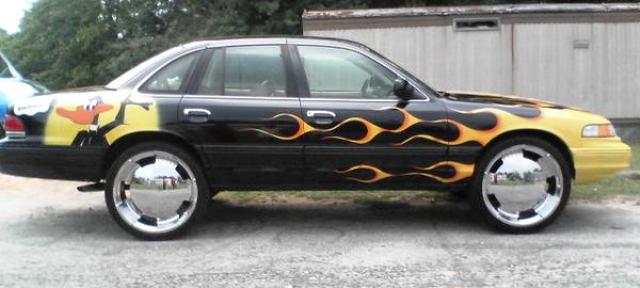

thanks for this information because actually I really am clueless on this rim topic. Ya know these kids are really into these rims and I guess from my perspective I see this deal as a huge risk and a lot of stress on a very small patch that connects the rim to the axel. You know when you have 27's on a crown vic outside of looking a little different.
:yikes:
